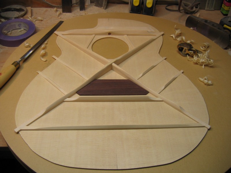

I finished off the braces tonight (I think) and would be grateful for any observations. I altered the rough braces as a result of the last suggestions and have now glued and shaped them. The top now weighs 239 grams, if that means anything.
Thanks again for your kind help! Especially to John Hall who took the time to make contact by phone and offer some great advice!

Looks really good!! I don't really know about top weight - depends on the guitar design and piece of wood you are working with, but I have one in the workshop that had to come off for a re-top and it weighs 245g so I think it will be great. And as it's your wonderful Lutz it will be sublime I'm sure.
What I do now - and it is probably hocus pocus - is tap all the way along each brace on the top, listening to how the top sound changes. I'm not tuning to any fixed note or anything, but am aiming to hear the top ringing and sustaining everywhere, and in particular listening to find points where the sound changes and loses ring/sustain. Usually these are places where the brace shape changes more suddenly and I do some fine snading/shaving until the ring/sustain returns.
Probably as I say hocus pocus, but I find I can spend an incredibly relaxing hour or do doing this. I showed this technique to Russell when he visited so maybe he can comment.
I'd be interested to know how the top's sound changes as you tap along the bottom legs of the X braces coming along the bottom of the scallops to the peak. I'm not a huge fan of "hump and bump" brace shapes and prefer the more gentle and gradual taper commonly known as "parabolic" (that reference is just to annoy Howard )Dave White38722.1870833333

Shane your workmanship is impeccabe. Very clean neat and very well executated.
PostPosted: Wed Jan 04, 2006 9:16 pm
Hi Shane
I like the bracing, it has nice gradual drops, which should give a very even tone, I am intrigued by the rear tone bars going straight across its not a design I have tried as I tend to use the rear tonebars to manipulate the sound, I will be very interested to hear the result.
Daves method of taping, makes perfect sense to me he looks for a response from the braces with dead spots. I am just experimenting with the method so will let you know the results. At the end of the day if you hear one of Dave's guitars they light up the room with a strong sound and beautiful tone, so I think his method works.
As Bob said the workmanship is beautiful, I Like the bridge plate size, should provide plenty of "drive".

Those two X braces look a lot like mine. Very slight sculpting vertically and a lot of sculpting from the sides making the brace thin and tall. That makes the most sense to me. The lightest possible brace to carry the load would have those features. Flexability near the perimeter of the top where it belongs, stiffness in the center to keep the trebles sparkling.   Looks good to me.

Looking good, I too am no great fan of pointy scalloping, prefering 'parabolic' shapes. Like Dave, I started tapping along each brace looking for dead points and shaving down where I found them. By the time I had finished all the scallops were gone and nice smooth flowing 'organic' braces remained, kind of like yours. Get's the whole top working.

My pattern and general brace shape looks a lot like that - but the bottom of the X has no peak - its a gentle taper from about an inch or so behind the x crossing down to about 2mm thick at the lining. The brace directly behind the bridge plate is about 1/2 inch high, scalloped ends down to about 3mm. The rear ladder brace tapers as well, from about 1/2 inch high onthe centre to the 2mm at the linings - its a little looser feel than what you will get with you current shapes here. The sound is generally big and open, no boom, even.
PostPosted: Thu Jan 05, 2006 2:35 am
awesome job shane. Looks like a Larrivee bracing. As for weight..that is right around the range I get..maybe a bit heavier... A top I braced yesterday and glued to the rim after all the voicing was done and it was ready to glue on the rim it weighed 225 grams. Top was about .110 - .120 thick...Adirondack spruce.

Dave, Russel and Colin, How you guys describe tap tuning is just like what Siminoff describes in his book, 'A Luthiers Handbook', looking for a constant note down the legs of the cross and across all braces. I did tap along and, as my ear is not trained for this yet, am unsure of what I am really looking for. I will though tap a bunch more tonight and shave a bit here and there and see what happens.
John, it certainly is a Larrivee design, most of the detail though came from an article Grit Laskin wrote in FWW in the '80's and from a brace picture I got off Linda Manzer's website (both apprenticed with Larrivee in the early '70's) and last from a Larrivee brochure. Sounds odd considereing all of the books on guitar making I have but I really like the sound of good Larrivee's so wanted to see what I could get with this pattern and those were were the best references for the pattern I could find...except maybe if I took Tony Karol's class! . 225 grams! I don't know if I could get that low. I had the cross shaped and added the rough braces and it weighed 252 grams. So I lost 13 grams shaping this much. The top is about .115 right now and will be a bit thinner when I finish sanding the face but even then, I don't know! But thanks for the reference.
Tony, thanks for the pattern specific advice. I will trim the bottom ladder down a bit and consider the cross brace in conjunction with Dave's suggestion of an even pitch along the brace, maybe the small scallop has to go. Actually, I think my lower ladder brace started at 3/8 or maybe 7/16 so it might already be close to yours, although I think that they finish more at 3mm.

Not quite. I'm not looking for a constant note or trying to tune the top to a set note as Simonoff seems to infer in his book. What I am listening for is that the top keeps ringing and sustaining everywhere I am tapping with no dead or very quiet spots. The actual note will change as you move around. Just hold the top loosely at the opposite corner and lightly tap the brace with your finger abd your ear close to the top to hear the ring. Also at the end, hit the top where the saddle will be and you should get a nice loud "pop" and ring. The "pop" is more apparent when the box is joined.
I don't think there is a lot, if anything, to be gained in concentrating on one note unless that's the only note you plan to play on the guitar
Alan C may have more to on this say but most of the specific note tuning comes when you try and get the top and back to work better as a unit. Alan has posted lots of times on this one.
When you do the sanding of the top with the box joined, if it were me I would be concentrating on the lower bout at the edges and behind the bridge towards the tailblock. IMHO you need some thickness in the centre for balanced/strong mids and trebles, and personally I like the centre to be nearer 0.12" to 0.125".

Well there are some differences in my 225 compared to yours. I don't use a tounge depressor brace as I utilize a different system. Aslo your lower face braces are heavier than mine, as well as your transverse looks larger than mine. But really not much of a difference in weight. I think you'll have a mighty fine sounding guitar on your hands.

The rear brace - well Larrivee's thoughts were that if you want an even sounding guitar (as opposed to a more bass heavy dreadnaught) make the bracing symmetrical. He has never to my knowledge done it any other way. He did for a while have something that looked like the pattern (in another thread with 5 I think) with three little fans behind the bridge brace - the tops rippled on him, so he stopped and went back to the single ladder back there.
I suppose I could ask the same question as to why the braces on a Martin style go at an angle - my guess is that it makes the top stiffer under the treble side of the bridge, and looser on the bass side. The bracing here is simply stiffer in the middle of the top, looser at the edges - like a speaker cone. At least thats my take on it.
Howard mentioned earlier up that he doesnt see how this bracing would work - in what way I ask wont it work - no matter how you brace a guitar, it will still be a guitar, sound pretty much like a guitar, maybe just different than other guitars. Angle the brace, dont angle it, put one two or three in there, double X it, change the height, width, shaping, whatever - it will still sound like a guitar, maybe just not as responsive or even as other guitars.
